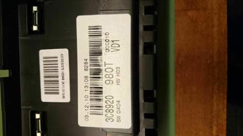

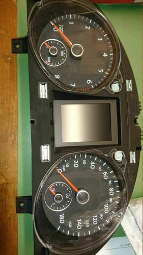

Ok, I just went down to the garage a had a look. Mine was produced in the end of 2010, so this is MY 2011. Part# is 3c8920980T.
Dsc-5047
Dsc-5048
- See above 3C8..MX is B6 2009-2010
- corresponding MX would be the next B7 (Otto, U5C, 9Q4)
1. QX - 2010/08-2011/05
2. TX - since 2011/05
wk205 has the right one :-)
@juergen3112 schrieb am 11. Januar 2017 um 20:49:34 Uhr:
- corresponding MX would be the next/first B7 QX (Otto, U5C, 9Q4)
Will the new 3D Version work the same and support all functionality? I see a 2016 one listed under the following:
3C8-920-981-PX (Otto, U5C, +9Q4,9Q5) ?
@wk205 schrieb am 11. Januar 2017 um 20:46:14 Uhr:
