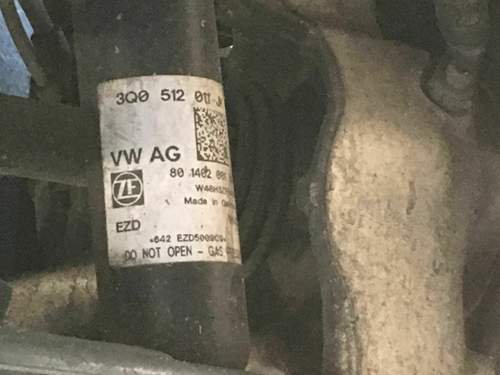

Habe ja weiter vorne schon mal geposted, dass mein Passat Gott sei Dank diese Probleme nicht macht. Fahre Dartfort 18" mit Conti Seal Sport Contact 5 & im Winter 17 Zöller aus dem VW Reifen Premium Paket mit 215er Pirelli Seal auf 2,7/2,8 bar. Bei den niedrigen Temperaturen poltert es mal bei heftigen Unebenheiten auf den ersten Metern morgens. Aber wenn die Dämpfer erstmal warm geworden sind, kommt nur noch ein leises, dumpfes de-dunk.
Hab mal das Typenschild vom hinteren Dämpfer fotografiert zum besseren Vergleich.
VG
Das sind auch die Dämpfer die ich vorher drin hatte und meiner poltert.

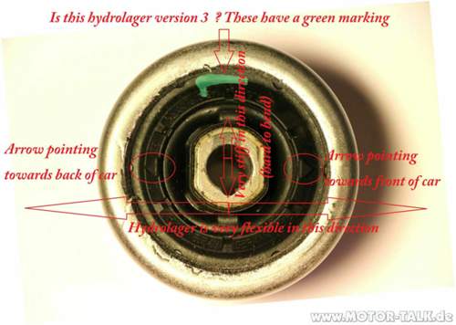

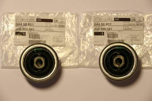

Hier you have the latest version of hydrolagern.
These have green marking in the lager. I think this is the latest (3rd) version cuz
previous (second version ) had blue dots. The original hydrolager didn't have any
marking at all.
I have tested these hydrolager by inserting a bolt into the bearing, and I noticed
these don't seem to have any mechanical parts inside the rubber bearing.
These bend to all directions, but it is easy to bend in towards the direction
front/back of the car; whereas the direction up/down is very hard to bend.
The previous (blue dot) hydrolager felt like there was also something mechanical inside
the bearing. I have the blue dotted in the car now, and the rear suspension makes
awful noise (klappert) when the temperature is below 0C (for example: - 5 celsius)
Sorry for English, but I can't explain this well enough in German
Please have a look at the photos
Will you change to the green marked ones?
Yes; we have a service time booked on Thursday 12th of Janunary.
Then I will know more.. Just hope this will finally solve the problem
cuz its been over one year since I bought the car, and all the time
some sorts of problems with the noises of the suspension.
