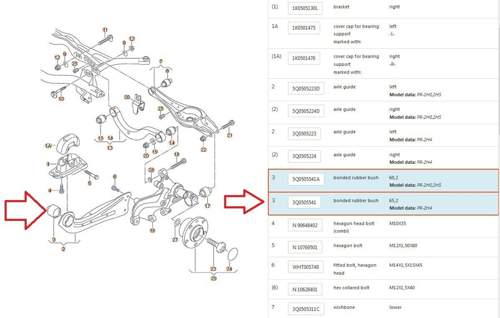

Wir haben "hydrolagern" 3Q0505541 getausch und danach war kein poltern.
Aber mit kaltes wetter ( 0C bis -10C ) poltern ist wieder zurück !
I have made a test: when the car was outside during cold weather (-10Celsius )
then I was spraying hot water (with a garden hose) directly to the above mentioned "hydrolager" ---> +20C and the noise disappeared. Then I waited for a while; and when hydrolager was cold -10C again - the noise is also back again.
Hydrolager is not just a simple "bonded rubber bush" - it has some mechanical parts inside it.
With a new part, you can bend it only sideways; not towards front-back direction of car. With a old (=noisy ) part; the hydrolager will bend towards any direction = it is worn out --> makes noise = poltert hinten
I just don't understand, what does the temperature got to do with it ? Are there such a narrow tolerances, that the cold weather makes the internal mechanics to become loose, and the noise comes back ?
Hydrolagern - teil nummer 3Q0505541
Siehe bild

Ja, das sind die Teile. Ich hab die auf meinem Bild falsch erkannt, die in Deinem Posting sind die Teile, die auch bei mir ausgetauscht werden. Bin mal auf das Ergebnis gespannt.
