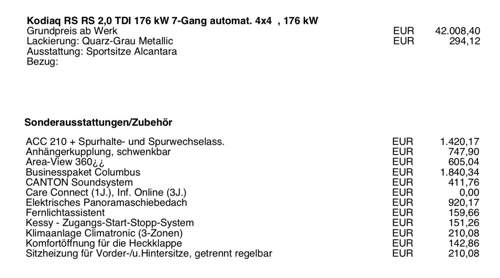

heute mal den Kodiaq RS im Leasing angefragt
volle Hütte - Gewerbe Leasing 3 Jahre 25tkm im Jahr knappe 470 netto - unverhandelt
kann man sich dafür antun ...
RS

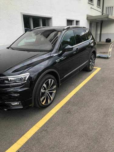

I am looking to buy a Allspace Business R-line with more or less all the options. The question is 20 inch, or 19 inch. According to the salesmen the 20 inch is rather hard/stiff due to the sport suspension. Someone has any experience with Tiguan Allspace on 20 inch? Is it really stiff or doable? And would DCC be a better option as it can increase comfort? Some reviews I found indicate the DCC hardly does anything. Not sure if this is true. Thanks for your help! I prefer 20 inch as it looks better in my opinion. But it should be still OK to drive and not hard as a racecar.
I have 20“ on my Allspace R-Line with DCC. The comfort is good, better than my Golf 7 Variant with 17“, sport Suspension and no DCC.
