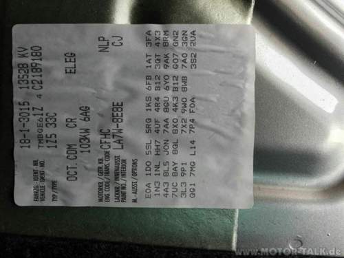

Der Besitzer des Wagens hat nochmals etwas genauer nachgeschaut und den Aufkleber doch noch gefunden 😁
Vielen Dank für die angebotene Hilfe!
Welche Bremsen passen an der VA? Ich würde gerne ATE Scheiben und Beläge kaufen.
Ich finde aber keine Nummer die zur Vorderachse passt...😕
PRCode: 1AT = Electronic stabilization program (ESP)
PRCode: 1D0 = Without trailer hitch
PRCode: 1KS = Disc brakes rear (Geomet D)
PRCode: 1N3 = Speed-related variable steering assist (Servotronic)
PRCode: 1NL = Covers for alloy wheels
PRCode: 2VA = Nameplate set GTI 16V Edition (without model designation)
PRCode: 3FA = Without roof insert (standard roof)
PRCode: 3GN = Variable cargo area concept
PRCode: 3L3 = Manual height adjustment for front seats
PRCode: 3QT = 3-point seat belts with tensioner and height adjustment front
PRCode: 3S2 = Black roof rails
PRCode: 4A3 = Seat heater for front seats separately controlled
PRCode: 4K3 = Radio remote controlled central locking operated from inside and safe securing
PRCode: 4R4 = Power windows with comfort operation andcircuit breaker
PRCode: 4VF = 1 2-point seat belt/3 static lap belts third row of seats in passenger compartment
PRCode: 4X3 = Side air bag front with curtain air bag
PRCode: 5RQ = Right exterior mirror: convex
PRCode: 5SL = Left exterior mirror: aspherical
PRCode: 6FB = Body-colored exterior mirror housings
PRCode: 6Y0 = Without cruise control warning system
PRCode: 7A0 = Without CD changer/CD player
PRCode: 7AA = Electronic vehicle immobilization device
PRCode: 7MG = Emission standard EU5
PRCode: 7P4 = Manually adjustable lumbar support in front seats
PRCode: 7VC = Parking heater
PRCode: 7X2 = Park distance control front and rear
PRCode: 8AY = Radio/navigation system
PRCode: 8GU = Alternator 140 A
PRCode: 8L5 = Roof antenna and diversity window antenna
PRCode: 8QL = Key for locking system with remote control
PRCode: 8RM = 8 speakers (passive)
PRCode: 8WB = Front fog lights
PRCode: 8X0 = Without headlight washer system
PRCode: 9AK = Climatronic with impact pressure control free of cfc
PRCode: 9P1 = Seat belt reminder electric contact in buckle
PRCode: 9W0 = W/o car phone preparation/installation
PRCode: B12 = Type approval Austria
PRCode: E0A = No special edition
PRCode: F0A = No special purpose vehicle standard equipment
PRCode: G07 = Front shock absorption
PRCode: HH7 = Tires 205/55 R16 91V
PRCode: J0N = Battery 330 A (61 Ah)
PRCode: L14 = Suspension range 14 installation control only no requirement forecast
PRCode: QG1 = Service interval prolongation
Skoda-pr-nummern
War wohl eher 2UA = Standard design
4UF = Driver's and front passenger air bag with front passenger air bag deactivation
7UC = Navigation system "RNS315" (integrated data storage device)
Passt besser
Wie lautet denn die Schlüsselnummer?
Ich habe für den Lackierer mal beim Lack-Code ein U mit einem V verwechselt wegen der behämmerten Punkteschrift auf dem Aufkleber.
Das war spaßig.
Nicht.
