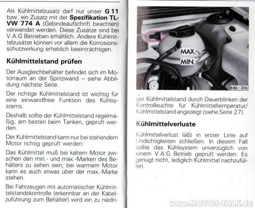

I think your bad idle running & bad accereration during cold engine is cause the blue colored temperature sensor dosnt work propper. (it`s a standart problem)
the flashing water-temp is may be cause you have a water-level-controll as shown at the following picture
hope it was helfull

I've already checked the blue sensor, measured the resistance, the voltage and checked the cables, all seems to be okay. Hmm... maybe I should buy a new one for sure?
About the flashing red warning led: in my Polo that water container has no sensor or any electricity. I had a thought that maybe the ECU makes the warning light to flash, so I disconnected the blue coolant temperature sensor, but no change. Then for sure I also disconnected the black sensor, but no change again. And I don't see any other sensor in the coolant system. 🙄
and there are
no other
sensor, the blue one is for ECU, the black is for Instrument,
so i dont know why it is flashing (i`m
mechanic
thats standart, level controll is optional.
at first please try to change the blue sensor for better engine running, it is not so expensiv, but i think the "flashing-problem" will remain.
Have a nice (Sun-) Day
The flashing LED can be caused by a defective instrument panel, but it also can be a broken wire or a short circuit, do you have a second instrument panel for spare ? checking the ignition system cannot be wrong too ;-)
