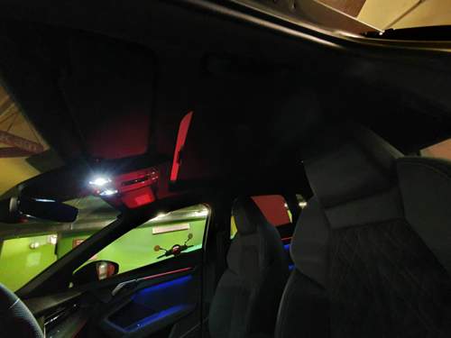

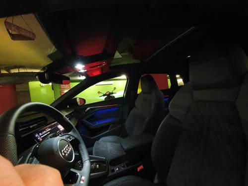

I have a A3 with panorama, no issues so faar.
pictures from inside out would be great 🙂
Here
