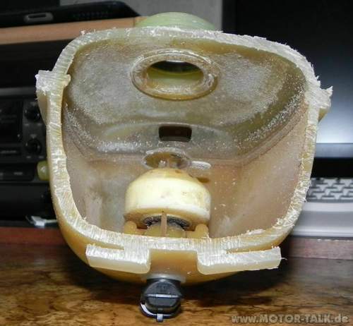

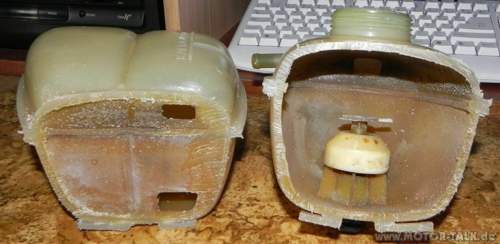

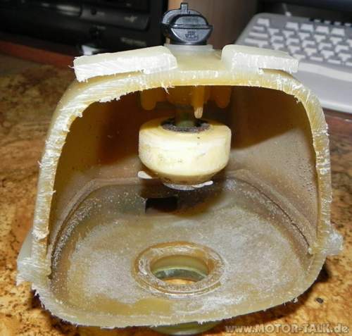

Anyway, it is possible to repair the "sensor" (clean the swimmer/floater) with a little effort. I uploaded some pictures so you will know what I am talking about.
The reason you get the "Coolant level too low" message is because the floater cannot freely travel on the plastic pillar it is monuted on. This is because the hole in the floater gets jammed with dirt and crud. You can't correctly clean it with water or detergent. The only good way it to get it off and clean it by hand.
The floater is made of lightweight hard plastic, not styrofoam, so don't worry, you can't squeeze it or damage it. The floater has a hole in the middle with a magnet ring inside. In the plastic pillar there is a relay switch which is activated when the floater travels past the switch. When it comes to approxinately 1 cm from the bottom, the switch makes a "click" sound and this sends a signal through the connector to the computer that the coolant level is low.
NOTE: Use my pictures only as reference. I completely opened the expansion tank and took pictures so you can see how it looks. You will not be opening the expansion tank. You will be doing all the cleaning through the opening on the top only !!
First remove the expansion tank from your car and let it dry. Then look into the opening at the top and you will see the floater on a plastic pillar. On top of this pillar there is a piece of plastic (like a plastic ring) which keeps the swimmer from falling off. This plastic piece can be taken off (at least in my case). Take some pliers (Spitzzange) and grab this plastic piece and pull it off.
After that, turn the tank upside-down so that the floater falls down. Keep the tank turned upside down and juggle it around until the swimmer flips over and lands with it's lower side towards the tank opening (which is now pointing down). The floater is too big to get it out so you will need to hold it in this position. Get a wire hook (or some other tool if you get a better idea), stick it through the hole in the floater, pull it towards the tank opening and hold it in position so you can clean it.
Then take a toothbrush or a cotton swab and clean the dirt from the bottom of the floater.
When you are done, release the floater and take the hook out. If you used a wire hook and can't get it out, just cut it and let it fall inside the tank and then take the cut off piece out. Then juggle the tank again holding it upside down until the floater flips back into the correct position (it's top side should be facing the tank opening). Then take a screwdriver, put it through the hole in the floater and guide the floater back onto the plastic pillar. Then take the pliars again and place the plastic ring back onto the pillar.
If you now turn the tank up and down you should see (hear) the floater move smoothly up and down the plastic pillar.
