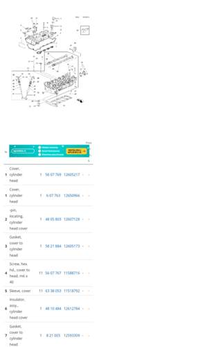

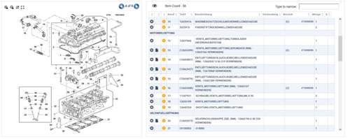

Kuerbelwelle
Opel Insignia 2.0T is A20NHT LDK.
Your picture is for LTG probably.
This is corect version
https://nemigaparts.com/cat_spares/epc/opel/g09/e5/15/
Chrome-screenshot
