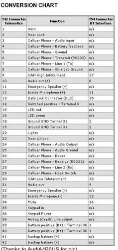

I tried looking for the bluetooth block underneath the seats but I did not see it. Is it hidden under the carpet or behind the central console? I thought it would be possible to identify the wires (I found this conversion char for the connector to the bluetooth unit).

Bild_1
Bluetooth is under the carpet and very complicated to reach.
The extra isolated green and black wire is micro +/- from the Bluetooth unit, the not extra isolated green and black wire is NF +/-.
Your Symphony is missing the connector D (your Photo 4) where this Pins are normally plugged in.
