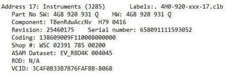

Hi everybody!
I've read this thread through translator and seems there's a lot of knowledgeable people here. Would there be someone who would be able to update my instrument clusters (416) software, have the oil/watertemp to show on the HUD and maybe adjust the LED's on the rev counter (up the redline to 7200rpm)? And all this would have to be done remotely unless somebody lives in Finland. 😁
So what I'm basically asking from you is for knowledge and patience to guide me through the process. You can of course name your price and I decide if it's worth the hassle. 🙂 PM me and we'll take it from there. Attached is the VCDS scan of my cluster if it helps. Vielen Dank!
Ki
Try out
Coding STG 17 / Long code / function 07
Byte 1
Bit 3 activ
416 .. da braucht er nicht viel probieren
Danke flitzer_wi, but as Scotty18 pointed out, this needs a lot more fiddling with the software and parametrization.
Yes - correct
