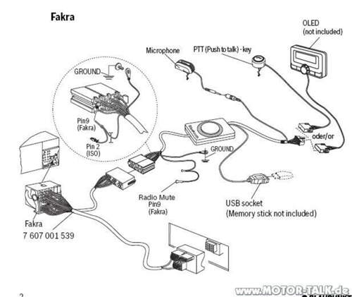

about the older one, i didn't try it because that time i wasn't able to activate cd-changer option and the old one is not supporting oled display. at least, i suppose so.
some more question's.
Do you use the Y Adapter between radio and IF like this:
http://www.caraudio24.de/.../...tooth-Interface-7607001539::16889.html
Like the jpg i have make as attachmend.
Firmware Version: i dont see clear on this site:
http://www.blaupunkt.de/index.php?id=894&tx_ddfproducts2_pi1[view]=960&no_cache=1&L=0
in Manuall _DE is 8c01 the newest.
in Manuall_eng is 8625
if for you 8c01 the newest, i woult try it.
since you have have download the the Firmware. zip there is a basic.txt include, maybe as zip again.
this basic.txt i would give a try,as config.txt, because it set all to zero.
an than try to start with this config.

Howdy,
I bought that Y cable, but in my Touran it is not enough space in the back for 2 quadlock connectors. So I managed to connected directly, miniiso to white cd/ black phone connector.
I will try these steps in weekend. Current status: RCD300 (no CD-changer option activate), BT adapter not connected to the car (with oled display and SW8625VW)
1. disconnect (-) from battery
2. connect bt adapter (to RCD300, to oled display and to microphone)
3. replug (-)
4. activate with VCDS the cd-changer option for RCD300
5. turn on RCD300
6. press and hold green button while switching off and on again the RCD300 (of course with usb stick in bt adapter)
7. waiting....
8. switch the RCD300 off and on again.
I hope it will work.
The steps are ok?

in this case i would test this zenario with the Y cable and RCD300 outsite, to get a status. cable on direct, cause Y one is more or less gone 🙂
If you proceed step7 , you press double on CD it should appear CDC , right? last time when i try it it was showing me no cdc, and came back to cd or radio...

Dear all,
Coming back with an update. I tested as I said, but, unfortunately, didn't work. I tried almost everything.
The final option was to send the units to a Bosch service. They told me that it was an error with the RCD300 software, not allowing it to communicate with bt/usb unit. So they rewrote the software.
Now I have a fully functional unit and bt/usb communication with this one. I can say that it is great and the sound is really good, even if RCD300 if an OEM radion unit. 🙂
