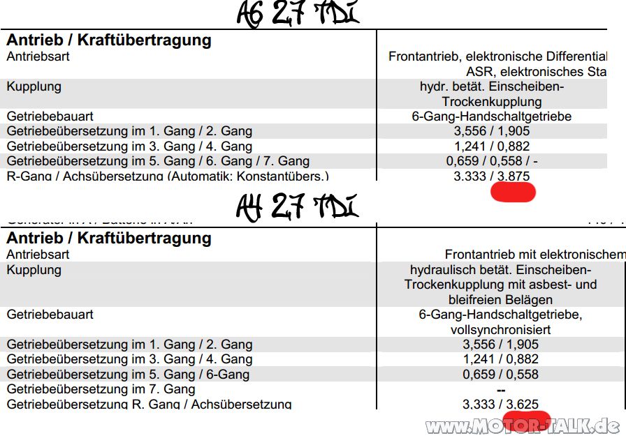

i need to install manual gearbox on a6 c6 (4F) (front wheel drive) 2,7 TDI (engine code BPP)
ETKA say me, that there are only 3 species: JMC,FZJ,HVD
http://data.motor-talk.de/.../fzj-2-7-tdi-190319054829699324.jpg
http://data.motor-talk.de/.../hvd-2-7-tdi-7709302113634993828.jpg
http://data.motor-talk.de/.../jmc-2-7-tdi-5283730710523683086.jpg
Please, tell me, what are their differences...
I also noticed that a4 with the same engine gearbox has different gear ratios: 3,625 (29/8) in a4 and 3,875 (31/8) in a6.
Thus a4 with gearbox from a6 will have increased torque.
question 2: is this true? what gear ratios were reduced?
thanks all...)
p.s. copy of the message in Russian language: (screenshot)
http://data.motor-talk.de/.../motor-talk-5776409896201344958.jpg

no no no...
On audi a4 gear ratios different.
gear ratios in a6 c6 4F 2,7 tdi = 31/8
gear ratios in a4 b7 8E/8H 2,7 tdi = 29/8 (torque lower)
(this info by ETKA program)
code of audi a4 b7 gearboxes: JME, HXR
This means that German engineers deliberately reduced ratios?
(Dies bedeutet, dass deutsche Ingenieure bewusst reduziert Verhältnisse)
p.s. great thanks all for information about dates!!! best info, best forum, best peoples, best cars!)

ok, i understand you...
but...i meant this:
http://data.motor-talk.de/.../bild--8599271614421819630.jpg
and I wanted to know why...
same same engine!) 2,7 tdi!)

some information I researched:
The gearbox-LETTERS are not the gearbox-TYPE. The gearbox-letters ends up in the gearbox-type. These depends on the time of build. For the A6 4F:
Letters FZJ -> Typ 0A2A for the period november 2004 until november 2004
(thats the time the 4F came out)
Letters HVD -> Typ 0A2A for the period november 2004 until may 2006
Letters JMC -> Typ 0A2A for the period may 2006 until october 2008
After the Facelift:
Letters JME -> Typ 0A2D for the period october 2008 until august 2011
For the A4:
Letters HXR -> Typ 0A2D for the period november 2005 until may 2006
Letters JME -> Typ 0A2D for the period juni 2006 until juni 2008
In my humble opinion the letter-code changed regarding to changes in the gearbox-ECU. I guess, there are no changes on the gearbox itself.
The 0A2A and the 0A2D are NOT the same gearbox.
The 0A2A is that one with 3,875 (31/8).
The 0A2D is that one with 3,625 (29/8).
Regards,
maLLoc

I do not quite understand this text (my english so bad...)
you think, that the difference of these gearboxes only on ECU?
gear ratios can not change the program
about a6 I understood everything.
I think, difference in gearboxes only "driven gear" (29/8 in a4 vs 31/8 in a6)

wenn englisch nicht hilft, kann ich ja auch deutsch schreiben und du schickst es durch den Google-Übersetzer.
Ich habe jetzt die genauen technischen Details rausgesucht. In meinem ersten Post sind leider ein paar Fehler, weil es dasselbe Getriebe (0A2) in Verbindung mit verschiedenen Kennbuchstaben doch mit verschiedenen Übersetzungen gibt.
Also:
Alle Getriebe 0A2 für Audi A6 4F, Frontantrieb, Handschaltung
mit Motor 2,7 - 130 kw - Turbo-Diesel
FZJ (=HVD):
Gebaut von 11.2004 - 11.2004
Achsantrieb
1. Gang
2. Gang
3. Gang
4. Gang
5. Gang
6. Gang
Rückwärtsgang
31 : 8
32 : 9
40 : 21
36 : 29
30 : 34
29 : 44

oh my god, thanks for this info!!! the best!
i surprised by the difference in gear ratios (29:52 vs 28:53 in 6-gang)
