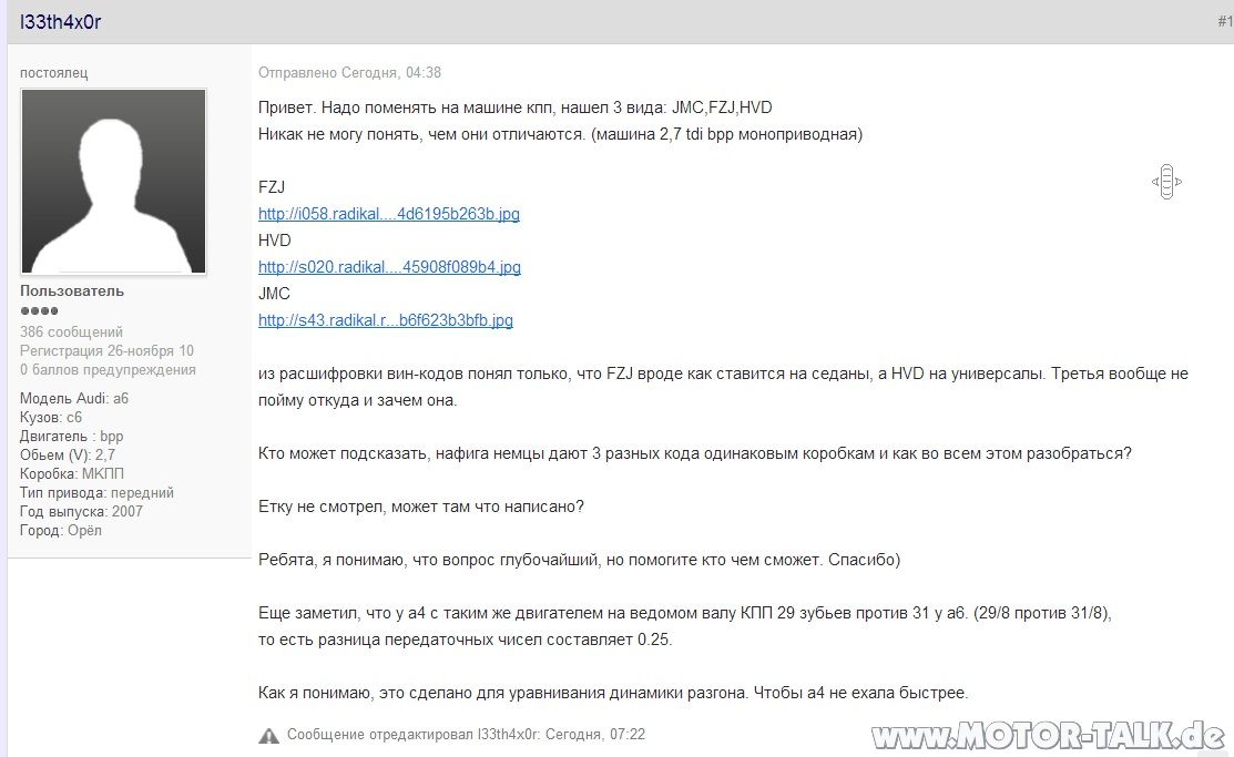

Hi, guys.
sorry for my english, i'm from Russia and sometime use google.translate 🙂
i need to install manual gearbox on a6 c6 (4F) (front wheel drive) 2,7 TDI (engine code BPP)

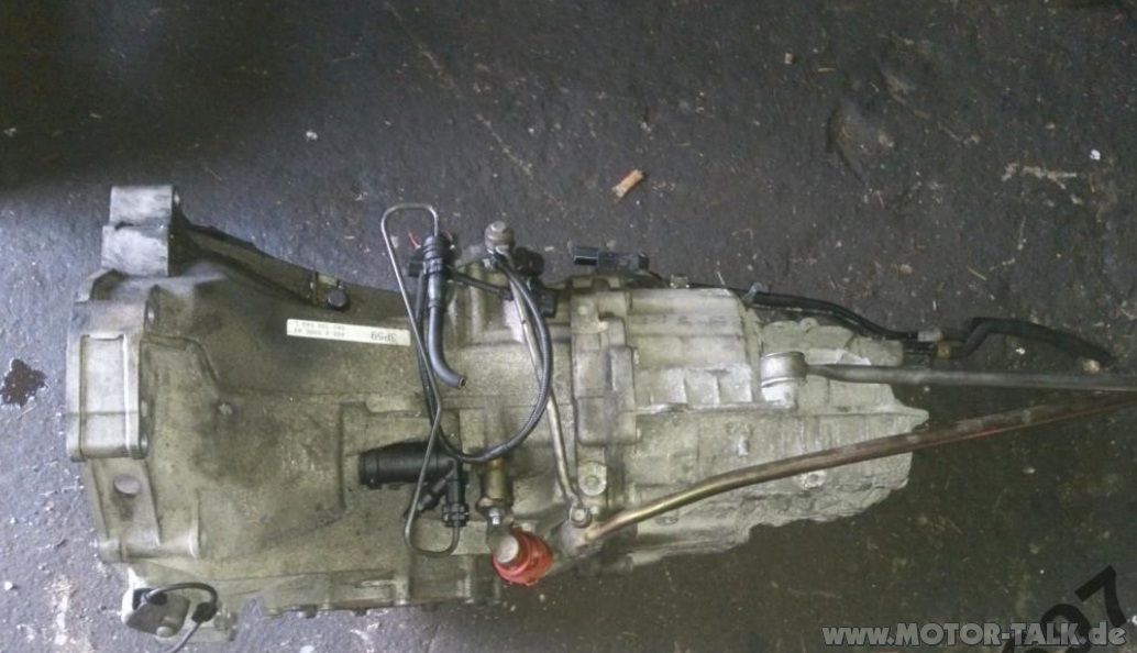

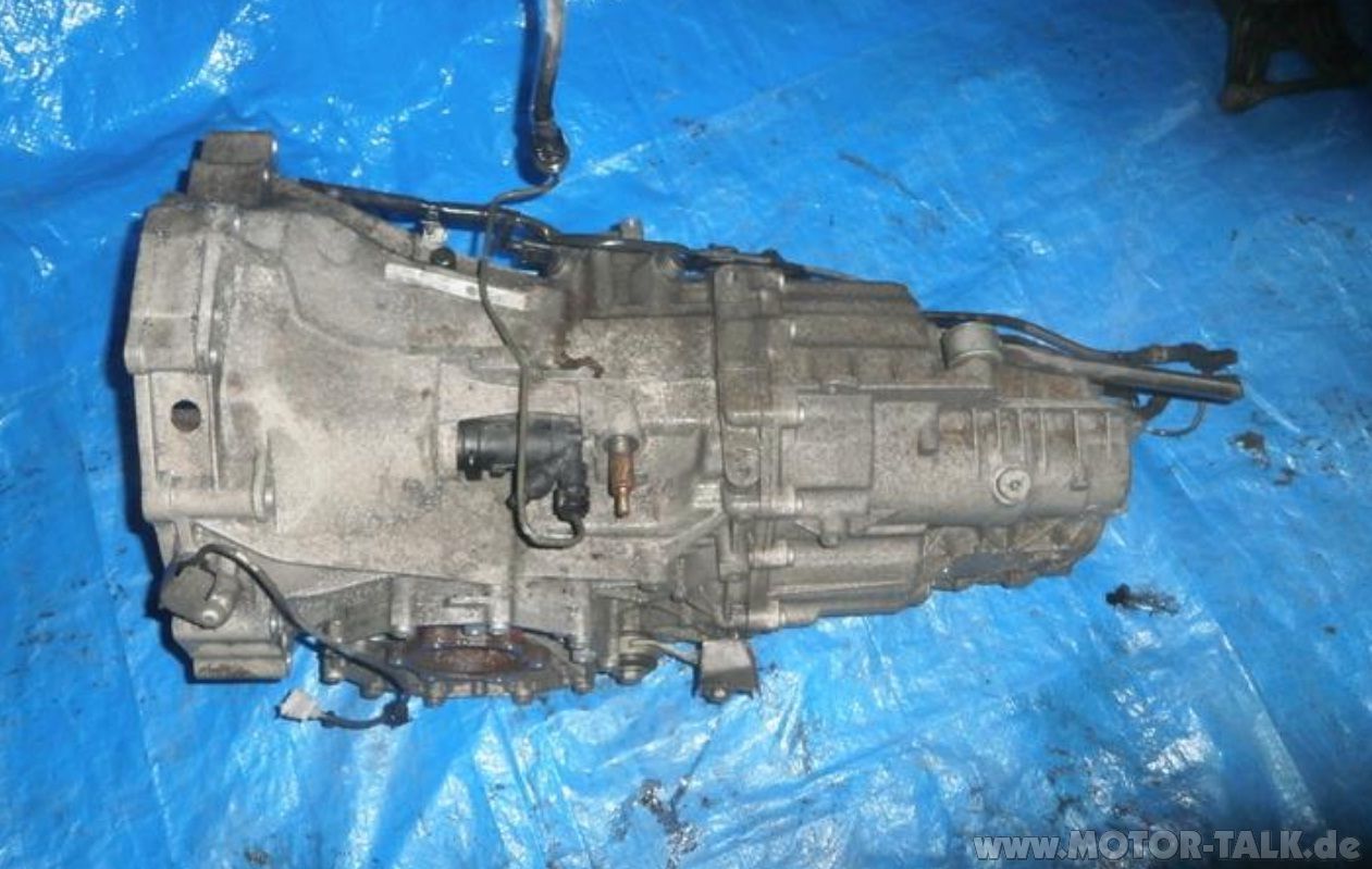

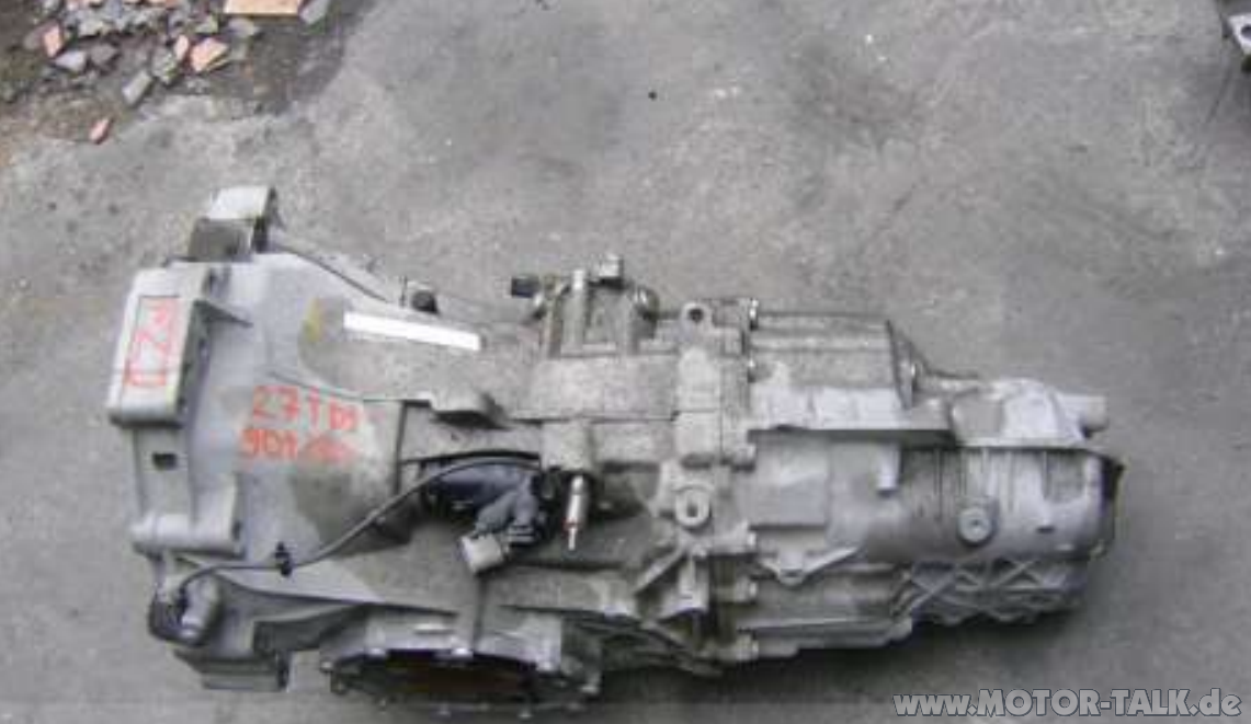

ETKA say me, that there are only 3 species: JMC,FZJ,HVD
http://data.motor-talk.de/.../fzj-2-7-tdi-190319054829699324.jpg
http://data.motor-talk.de/.../hvd-2-7-tdi-7709302113634993828.jpg
http://data.motor-talk.de/.../jmc-2-7-tdi-5283730710523683086.jpg
Please, tell me, what are their differences...
I also noticed that a4 with the same engine gearbox has different gear ratios: 3,625 (29/8) in a4 and 3,875 (31/8) in a6.
Thus a4 with gearbox from a6 will have increased torque.
question 2: is this true? what gear ratios were reduced?
thanks all...)
p.s. copy of the message in Russian language: (screenshot)
http://data.motor-talk.de/.../motor-talk-5776409896201344958.jpg
Hi there,
According to this webpage, those gear boxes have been used during the following time periodes on A6 models:
FZJ: November 2004
HDV: November 2004 - Mai 2006
JMC: Mai 2006 - October 2008
