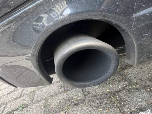

I am afriad that I will indeed have to replace the DPF. If you take a look at the attached photos, I think there are soot residues.
I have made an appointment with my dealer, but the earliest available date is 4/10. Is it bad if I continue to driving until then?
...the carbon deposits are a sure sign, the inset is broken.
As I wrote: compornents downstream could be contaminated beyond repair (cleaning).
NOx-sensors: They function just like a standard oxygen sensor (lambda sensor) - so cleaning them might be successful as well.
SCR-catalyst: It's inner surfaces are coated with a variety of chemical compounds in order to facilitate the breakdown of the NOx-molecules. I don't know whether these surfaces can be restored.
Particulate sensor: According to the BMW shop manual it must be replaced, anyway.
In order to reduce carbon deposits while driving with a broken filter, deactivating the EGR would be very effective.
Unfortunately on Your G-model is no easy way to do that, because BMW has made it tamperproof - back then it was just pulling a plug. Doing this on Your car, it will go into limp mode.
Another measure to run the engine cleaner ist to switch from standard-Diesel (B7) to synthetics like GTL (GasTolLiquids), HVO100 (HydrotreatedVegetableOil) or ARAL/BP-ULTIMATE.
Maybe this will make You "survive" til October.

...with an undamaged filter Your tailpipes should look like this (mileage 215.000km)
