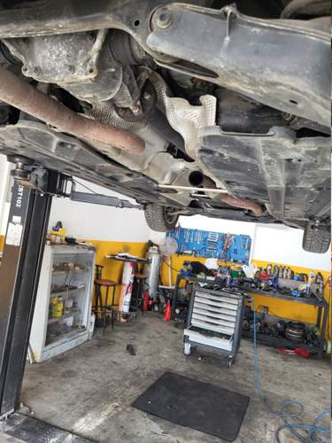

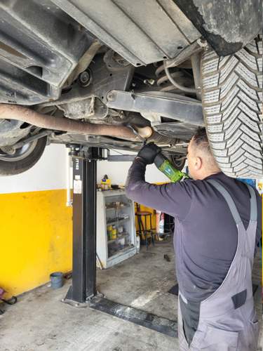

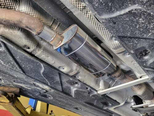

Sorry, in English, but no more crackling for me 🙂
20240316
20240316
20240601
