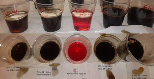

I changed differential oils to few cars couple days ago. Oils were were quite black. Car which came from belgium with higher mileage had better oils than car with lower mileage which came from germany.
Oils
