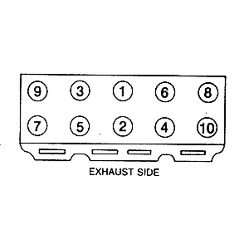

Mhmmm, vielleicht kann mir jemand was zu den Anzugsmomenten der Zylinderkopfschrauben des Olds Kopf sagen ?! ;-) .. Ist der mit den 10 Schrauben pro Kopf

NEW head gasket(s) should always be used. Match the old gasket with the new one to make sure they are exactly the same. Gaskets on the 260 V8 must be installed with the stripe facing up: 307 V8 gaskets do not have a stripe. If the gasket has a bead, install it so the bead is upward. If there are dowel pins, locate the holes in the gasket over them. On the 285 and 301 engines, coat all rocker stud lower threads, the cylinder head bolt threads, and the underside of the bolt head with thread sealer. On 1986–87 3.8L V6 engines, coat the bolt threads with a heavy body thread sealer. On all engines, the head bolts should be dipped in clean oil before installing. Except on the 1986–87 3.8L V6 and 1988–90 5.0L V8, tighten all head bolts in sequence and in small stages to the specified torque.

Fig. 1: Buick built 350 and 455 cylinder head bolt torque sequence
Fig. 4: Oldsmobile built V8 cylinder head bolt torque sequence; except diesel
Fig01
Fig04
