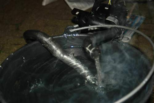

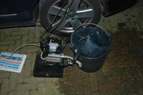

SH Test-Lauf 1
SH Test-Lauf 2

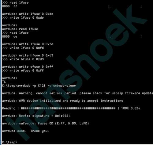

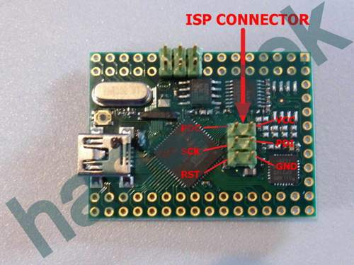

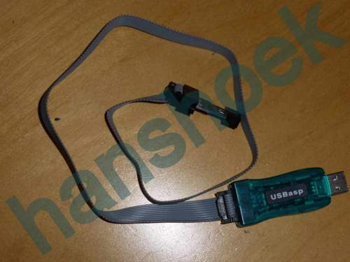

How to reflash a AT90CAN128
In my previous post I explained the installing of an AT90CAN128 with firmware of BRONKEN to disable the automatic function of the auxiliary heating (ZUHEIZER).
This firmware can be installed by a PC (or MAC) application “Chip45boot2” and is very easy to use by USB. The Chip45boot2 can only be used if there is a dedicated bootloader (pre)installed on your AT90CAN128. So after the Bronken firmware has been loaded on the AT90CAN128 you need something else to program it. For example if you need to flash a new revision or when things go wrong.
What do you need:
- ISP programmer with 6 pins connection, I used this one: ISP programmer on Ebay
- 6 PIN connection on your AT90CAN128
- Drivers for above, I used from: USB-ASP Drivers from Fischl
- Application to flash ; I used AVRDUDE, available from: AVRDUDE @ Non-GNU
- Bootloader image, to obtain from: Chip45
Procedure:
Extract the downloaded bootloader, it will contain many files. You must look for something like: chip45boot2_at90can128_uart0_v2.9Q.hex (especially the ‘0’ from uart0 is of importance, this is pointing to the USB). I copied and renamed it because you have to overtype it later 🙂😁.
Install the drivers and software and connect the ISP interface with the PC and the AT90CAN128. There should be some indication on the ISP connectiors, watch for it; they should match! No external power is needed, the ISP connection powers the AT90CAN128.
Now start the AVRDUDE application, from a DOS-command box. See screenshot how to set the fusebits and next screenshot how to flash (I renamed the hexfile to “chipboot.hex”).
After this the bootloader should be repaired. You can disconnect the ISP programmer and will be able to Chip45boot2 again bt USB.
Cheers.
