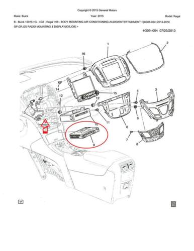

so, ich habe wieder etwas zeit in informationsbeschaffung und Gespräche investiert. folgendes sind nun meine "finalen" Erkenntnisse, leider nicht zu detailreich…
- das HMI liegt bei uns im Insignia hinter und unter dem 8" Screen. Wir sind baugleich mit dem Buick Regal aus den USA und von denen habe ich das Bild her.

- True car play requires everything on the most bus to be replaced so about $3000 worth of hardware and software.
- Carplay required a much faster processor and the addition of other commands for various modules. To get TRUE OEM car play you have to replace at minimum the IPC, Radio Module, Disc Player, HMI etc… Simply put there is NO way to add car play to your existing hardware.
- The mirroring is accomplished when your vehicle has rear seat entertainment we use those inputs to display on the front screen. If your car can play DVD/BluRay right now thats an option for you. Its not Car Play its simply mirroring the display of an iPhone on the screen.
- https://www.youtube.com/watch?v=6xfaZZ6ArCo
All of those solutions are around $1300 with a core exchange which you cant use since you have a euro spec model without core they are about $2000 and DO NOT include the siri eyes free portion as thats controlled by the upgraded cluster which is another $600 + $300 in custom programming and with freight you are about $3000 easily. Mirroring displays the iPhone interface itself not car play on the screen from an RSE equipped vehicle. AGAIN YOU CANNOT GET CAR PLAY WITHOUT SWAPPING HARDWARE! PERIOD.
Sorry but you have to understand this there were many hardware changes to make this happen. If you want to half ass it and skip the siri eyes free and the rest of the cluster integration you can do the ~$1300 + core refund which I believe is another $500-$600 so you are in $1900 already.

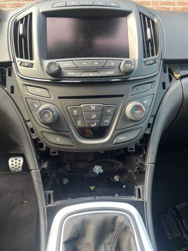

Hi Leute. Ich will gerade mein hmi 2.5 Upgrade durchführen und habe nur 2 Anleitungen bei YouTube gefunden. Beide auf Englisch. Bei beiden scheinen nach Abnahme der Verkleidung noch 2 Schrauben gelöst werden zu müssen. Ich habe an diesen Stellen aber keine Schrauben. Das Radio will auch nicht einfach raus flutschen. Jetzt habe ich Angst was kaputt zu machen. Hat jemand einen Rat wie es von hier an weiter geht? Siehe Foto.
Edit: man musste nur das Display entfernen und kräftig ziehen. Hat sich also erledigt.
