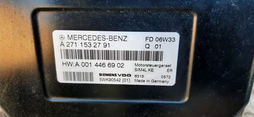

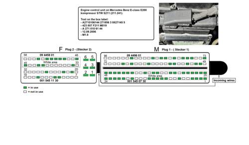

No, not at all. Sorry about my messages. I'm trying to figure out that what is the problem. Getting error message that claims about camshaft position sensor from exhaust side. Replaced with aftermarket sensor. Still car won't start. Now I believe that there might be something else going on. Are you angry on me? Just trying to fix my car. It has now been standing on the front of my flat since of the end of March 2022. Gone through nearly everything. Fuses and relays are ok. Gasoline is coming with good pressure. I don't own nasty thing that cold measure pressure. Real wiring diagram is needed. I have cleaned MAF and carburator intake. Maybe I should just sell it away as it is.
Checked out these F- and M-plugs of my car.
F-and-m-plugs
