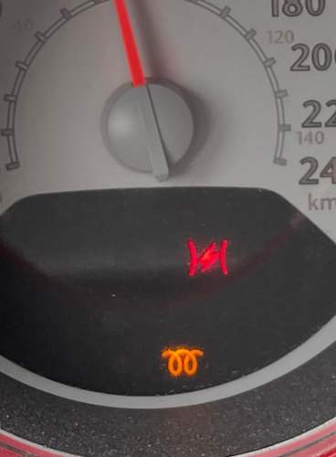

Hallo zusammen, ja es hat auch mich erwischt, kann mir jemand bei dem Symbol / Kontrolleuchte helfen? Es taucht auf, meistens bei einer Autobahnfahrt der Motor verliert erheblich an Kraft lässt sich aber mit 120 km/h fahren.
Danke im Voraus
Stani

Hi Segler,
Das Boardbuch sagt dazu folgendes:
17. Electronic Throttle Control (ETC) Indicator Light
This light informs you of a problem with the
Electronic Throttle Control (ETC) system. If a
problem is detected, the light will come on
while the engine is running. If the light remains
lit with the engine running your vehicle will usually be
drivable and not need towing, however see your dealer
for service as soon as possible.
If the light is flashing when the engine is running you
may experience power loss, an elevated/rough idle, and
increased brake pedal effort, and your vehicle may
require towing. Immediate service is required.
The light will come on when the ignition switch is first
turned on and remain on approximately 15 seconds as a
bulb check. This is normal. If the light does not come on
during starting, have the system checked by an autho-
rized dealer.
