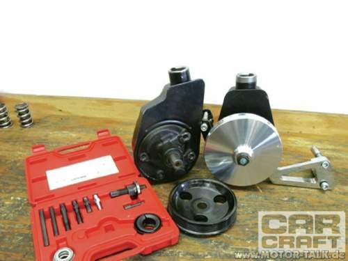

If you are a celebrity in America these days, it’s nearly a requirement to spend at least a week in some trendy, beach rehab facility. Thankfully, we’re not celebrities, but one of our junkyard power-steering pumps recently suffered from leak issues and cried out for rehab, so maybe we’re more tragically hip than we thought. With our minds now cleared from a synthetic power-steering-fluid-induced haze, we thought it might be interesting to show you how easy it is to put your classic GM Saginaw pump through rehab and have it come out a clean, happy, and fully functioning member of our high-performance society.
The Saginaw power-steering pump first made its appearance on GM cars in 1960. The early pumps used a threaded 5?8-inch-pulley-shaft-diameter fitted with a woodruff key. Later, GM changed to a larger, 3?4-inch shaft minus the threads and woodruff key, converting to a press-on pulley. According to RockAuto information, GM was still using this pump in some LS truck applications as late as 2009. The fittings and fasteners in later pumps merged to metric at some point but retained the same basic pump configuration, with its integral fluid reservoir. The ’65 and ’66 big-block Chevy applications used a smaller pump housing that relied on an external reservoir. If you like the idea of a separate reservoir, Original Parts Group (OPG) reproduces that pump cover. One thing that makes this pump so popular is that the same basic reseal kit will service all pumps between 1960 and 2009, and you can find one from RockAuto for less than $10.
We mentioned that the Saginaw pump went metric at some point in the later ’70s, but we discovered that the thread pitch on the high-pressure output fitting that screws into the pump is so similar that the older SAE output fitting will screw right into the metric-pump body. This is important because the older pumps use inverted-flare fittings, while the newer ones use a Saginaw O-ring fitting. So if you want to update your ’60s GM pump with a newer ’90s Saginaw pump from the junkyard, the exchange is a snap. In most cases, even pump housings will interchange. If your pump housing is beat up, Tuff Stuff offers both natural and chrome housings that will fit most applications. So this means you could snatch a newer pump out of the junkyard, slip on your original pump housing (or a new one from Tuff Stuff), add new seals, and have a virtually new pump for very little coin. Plus, you can reuse your original pressure fitting to retain your original high-pressure hoses, so you don’t have to buy new hoses. There’s also a smaller, late-model power-steering pump called the Type II that we have some tricks for, but we’ll save for a later story.

Text zu Bildern:
01: Car crafters love interchangeability, and there are very few GM parts that have remained basically the same from 1960 to 2009. The pump on the left is the newer, metric version with a press-on pulley, while the one on the right is the older, bolt-on version with a threaded shaft and a woodruff key. To disassemble the pump, the first step is to remove the pulley. Newer pumps require a specific power-steering pump puller/installer. You can buy a decent universal puller/installer from Summit Racing for a fair price.
