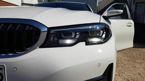

I have just had my G20 320D updated with software 03 / 2020.40, and now I see that my cornering lights are always on when headlights are on (not when only daytime running lights are on). I have the headlights with extended features (not laser and not the standard LED).
Anyone noticed same issue?

You likely used a version of software for a country like USA which has this feature as mandatory ON.
Hi - spoke with my dealer who confirmed I have DK version of the software and will look into this. Anyone else with software 03 / 2020.40 who could check if this also applies to them? Could be helpful to understand if this is a new feature or an error in my software.

Do you have picture?
I fail to see how this is a bad thing. With laser lights this is normal behavior.
Best Thor
In Denmark the lights are mandatory to be on all day. Therefore a different software. The only error I do see is that either your car is imported from Denmark and was therefore a DK version or you picked a wrong software.
If your dealer confirmed you got a DK car, well....you got a DK car.

So here is the picture, where you see that the cornering lights are on, when lights are set to Auto. Before I had this software update cornering lights only turn on when below 30 km/t and activating the turn indicator. Now both of them come (like permanent fog lights). Not sure if this is an error of something BMW decided to do in their latest software update.
Interestingly enough, if I deselect the Auto light switch and instead select low beam manually (there is a switch for that) they dont come on, which makes it even more strange, as if this was an intended feature, they should come on regardless. There is not a separate button or option to configure the Cornering lights anyway to my knowledge. It is software coded.
Those of you who have Cornering lights in your BMW G20 or G21 do you experience the same? If so I assume it is deliberately by BMW, but if not, they need to fix it. Appreciate you input

Was at the dealer yesterday, and he spoke with BMW genious for the Nordic countries, who was able to confirm or deny that the new software would result in change to how Cornering lights operate. But they were of the opinion that it likely was a mistake in the software version, so might be corrected with later version.
Am I the only one who noticed this? Or anyone else with 03 / 2020.40 and Extended LED who can check if both cornering lights are on at low speeds when Headlights low beam switch on? As my car is parked in basement my headlight low beam always comes, so for you to check if the same happens to your car, you would need to be parked somewhere 'dark' as it otherwise will only by DRL which you can see.
