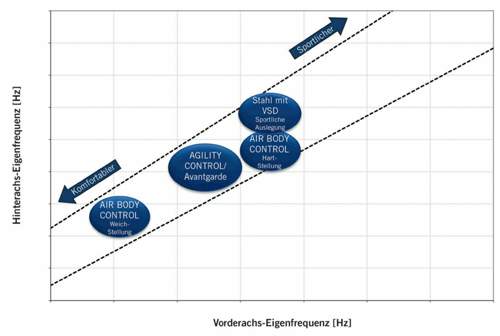

  • The effect of changing settings in the ABC is very apparent, i.e. it is doing its job relatively well). As in a Mercedes-written book (see below) the normal Agility suspension is considered to be more close to the Sport mode, it can be easily compared to the properties of Comfort mode. That gives you an easy way to decide.

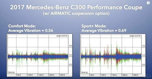

The only "scientific" measurements on ABC I found in a youtube movie, where a Mercedes C-class and Porsche are compared. There it is obvious that the ABC is doing its work (see first image).
Some other reference can be found in the book Mercedes-Benz E-Klassel; Entwicklung und Technik des W213. In the book a symbolic picture can be found, expressing the dampening and eigenfrequencies (see second image).

Comfort-versus-sport
Hinterachs-eigenfrequenz
