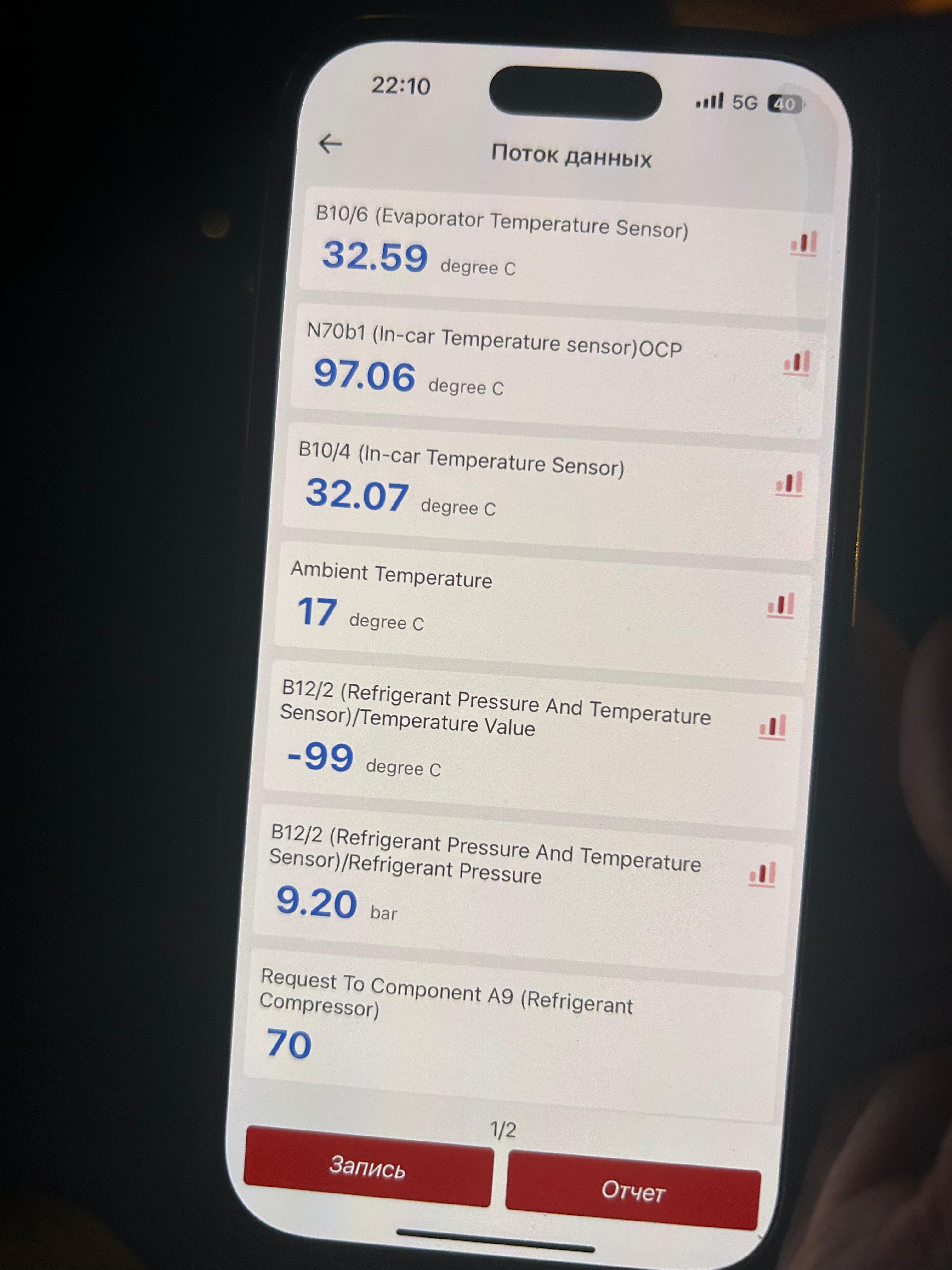

Hello guys, I need your help. As you can see in the picture, I have problems with two sensors, that’s why I don’t have cold air in the car. I changed sensor B12/2 for temperature and pressure, but the values stayed the same. I also changed the AC, but it still doesn’t work properly — sometimes I get cold air, sometimes I don’t.

What do you mean you changed the AC? Does that mean you changed the control module? Why didn’t you perform a proper diagnostics first before you started changing good components with new components? Most of the time the faults are symptoms, not the underlaying causes. That’s how grease moneys in shops and stealerships work. Changing components and parts until the problem is solved instead of thinking logically what problem could cause the symptom. And they always start with the most expensive parts down to the cheapest. The dumb customer will pay no matter what.
That's the way to make money for a garage without any idea what's the real problem🤪
But it's really interesting what "I also changed the AC" means...

The AC sometimes blows cold, sometimes not. One of these sensors, specifically B12/2, was replaced, but its value stayed the same – it only shows the pressure.

I replaced the AC and the B31 multifunction sensor. I also checked the sensor in the OCP, and the small fan is operating correctly.
Ich habe einen anderen AC-Modus mit derselben Teilenummer ausprobiert, ohne ihn dauerhaft zu wechseln, und die Fehler bleiben gleich.

Stop replacing random parts. This is utter nonsense what you’re doing. Either diagnose the problem yourself or go ask someone who knows how to diagnose it properly. None of the components you replaced have anything to do with your issue.
Es wurde nur der Sensor B12/2 ausgetauscht. Alle übrigen Komponenten wurden lediglich geprüft und anhand der gleichen Teilenummer kontrolliert, ohne dass ein Austausch erforderlich war.
Das Problem begann damit, dass das Kältemittel auslief. Wir waren beim Bosch Service, dort wurde das Leck gefunden und behoben. Danach wurde die Klimaanlage wieder mit Kältemittel befüllt. Wie bereits erwähnt, kühlt die Klimaanlage manchmal, manchmal nicht. Selbst wenn sie zunächst kühlt, geht die Kühlung nach der ersten Ampel wieder verloren.
