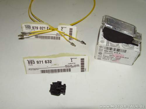

''''Glaube er meint, obes möglich ist die originalen Module von den Fußraumbeleuchten in den Türen zu verwenden!''''
That’s correct,
When I buy the red/white LEDs from Cristian.
Than I have original white LEDs spare, anyone know of its possible to put this LEDs in the units below the door, so I have better white light in the door (now it’s more like yellow).
You can see in the attachments the pictures of both units.
They have a different 2 polig connector, also the wire ring cables have different clips.
Thanks, Peet
(Sorry for my German text, I am from the Netherlands, so I try it in English)

Hi Peeet,
no it´s not possible. In the doors the lights use the W5W socket.
From my point of view you should use either:
http://www.hypercolor.de/.../Power-LED-Lampe-W5W-radial.html
or
http://www.hypercolor.de/.../Standard-LED-Lampe-W5W-radial.html
I have the ones in the first link with 5000k. They are really, really bright (a lot brighter than the old foot lights)
and have a nice neutral color, fitting to the rest of car. The only drawback of the 6er (first link) is that i could not
close the black casing body.
It is possible. But you need to modificate some points.
But peet need to change the plugs in the door.
an other possibliy is to create an adapter from one plug to the other plug.
Peeet an other question. for me it looks like the door light are not build in from factory.
Is that right?
I also use the original lights with leds pluged in.
Here you can see http://www.fuers-auto.de/product_info.php?...
BR Robert
OK, thank you ''Audimann77''
I know about the hypercolor leds.
But when I not use the original footwell Leds any more, i want to use them for the door lights.
I thinking to rebuild the connectors/plugs, so I can use the orginal footwell lights.
''no-legend'' Thats correct.
I make the complete retrofit from the ambient lighting, by myself, so I am not afraid from some new cable work.
You can read over here that topic with DIY, page 7 post 249:
http://www.audizine.com/.../346857-DIY-Ambiance-Lighting-(Full-time-adjustable-foot-lighting)?p=6207029&viewfull=1#post6207029
Peet
