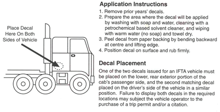

position der sticker
http://www.sbr.gov.bc.ca/.../IFTA_Decal_Instructions.gif
