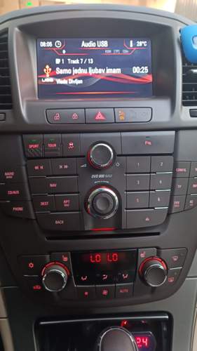

For DVD800 there are 2 media:
1.DVD with maps of Europe for year 20XX/20XY
It can't be copied, must be original, no other way
2. CD with softver update for DVD800, must be correct depending on manufacturing year. Can be downloaded and burned(at lowest speed), it will work.
This CD can be modet(I done it, its cool) so grafic is changed. There are done version of it so just update software and change day/night grafic at same time.
After update maps are intact.
Night mode
