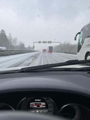

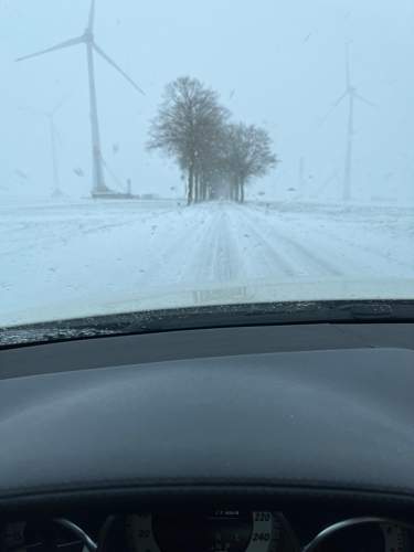

I drove my last car (Mercedes CLS Shooting Brake X218 - about 2 tons and 4WD) on Pirelli P-Zero Winter 255/40 18“. The car before was a Mercedes E Class S212 (also about 2t and 4WD) on Bridgestone Sottozero W240. Both of them has their successor on the market.
I was satisfied by both of them. And I had to drive during hard winter conditions temporarily (see picture). They performed well, kept the track well especially in 15cm fresh snow. As I am driving relatively reserved I didn‘t push them to the limit. For me they met all requirements. So for large and heavy cars with much hp I can recommend them! The Audi A4 is not as massive as a CLS or an E Class but not that far away (depends on motor 1.5 - 1.9t).

I forgot the pictures…
Bild #211497389
Bild #211497392
