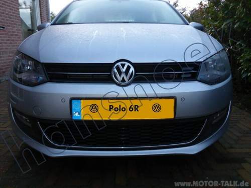

Final results and conclusion
At final stage I coded the module with VCDS. It should be added on address 10 and several settings can be changed. With long-coding-helper and modifying parameters in some documented channels it should not be a problem.
Considerations:
Pro’s
Original look
Reasonable price
Wiring pre-manufactured
Con’s
Switch was extra work
Poor manual and support
Sensors stick out bumper surface
Sensor holders look and feel inferior to original VW
CAN cable not twisted
Conclusion:
A very recommended mod! :D:D:D
I was very happy to have the PDC completed and it works very well. It was a lot of fun installing it. Now the Polo has a valuable option and driving is much more luxury by now.
Front result
Front detail
Rear result
