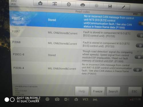

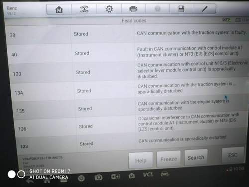

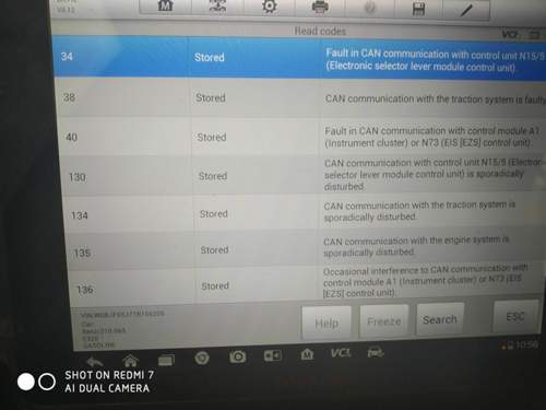

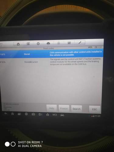

I got a bigger scan tool (autel maxisys) for the 38 pin socket and got these codes:
P1876 signal sent by control unit N47 for wheel speeds and the braking torque are not available on the CAN bus
B1101 fault in CAN communication with control unit N47-5
134: CAN communication with the traction system is sporadically disturbed
B1100 communication over engine CAN bus is faulty
B1102 fault in CAN communication

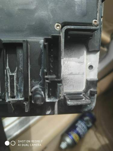

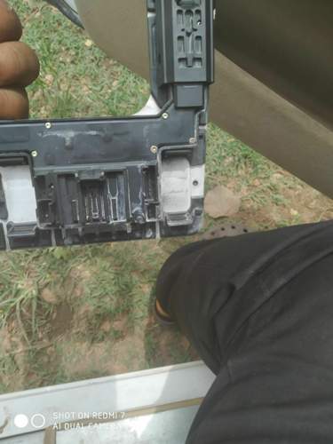

In diesem VD wird das Getriebe Steuergerät gezeigt ist auch in deinem Steuergerät Öl ?
Die Sicherungen im K 40 (Bild) prüfen. Sind diese OK ?

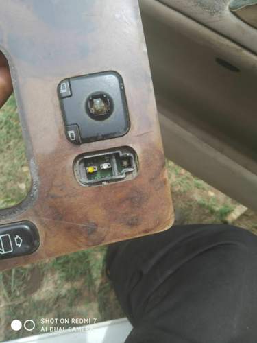

Thank you! Seems I have gotten a divine way out. I suspected some spillage on the the place where the window buttons are on top of the transmission shifter.... As I noticed that the airbag light remained on even when the ignition is off (very unusual). So I disconnected the button panel and saw some corrosion at the plug.... leaving it disconnected I took it for a spin and voila...no error, no malfunction for over 20 minutes of mixed driving. Thank God. And thank you all for assisting with this issue.

Would you like to add a picture of the meaned plug? Maybe it will help anybody else.

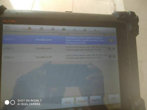

I suppose, that this wont be the reason of the increased fuel consumption. You still should check your lambda values and your air flow unit.
This here
Img-20210409
Img-20210409
Img-20210409

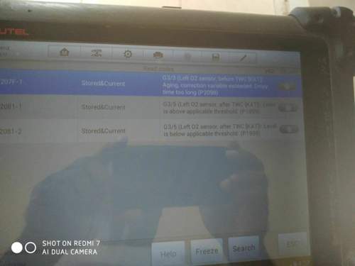

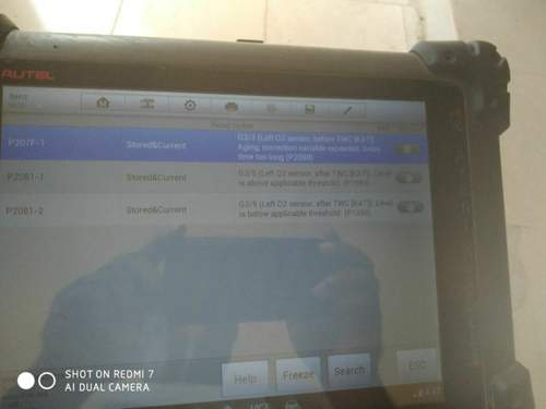

For the increased fuel consumption, I cleaned injector nozzle on cylinder one and replaced the sparkplug there to repair p0301.
Now to the lambda's here are the scan results
Lambda
Lambda1
Lambda2
