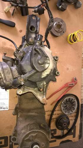

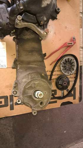

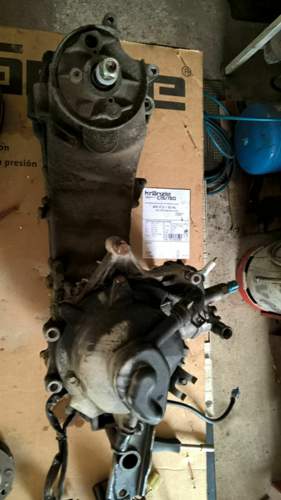

Wp-20170916-15-36-04-pro
Wp-20170916-15-36-08-pro
Wp-20170916-15-36-15-pro
