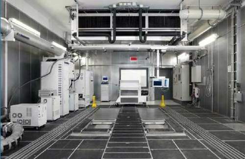

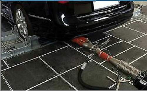

Bild01 / Bild02:
A fully equipped Horiba emissions test cell including an ADS-7000 Automatic Driving System. When integrated with appropriate measuring equipment, a chassis dynamometer and the test cell computer, ADS-7000 allows automatic laboratory operation

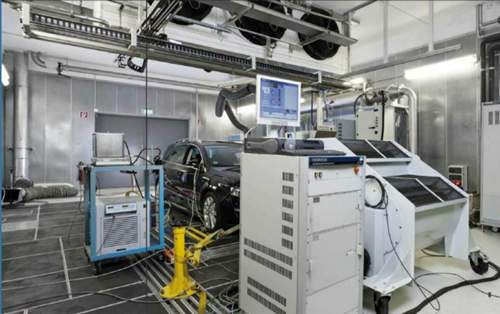

Bild03:
Horiba’s chassis test cell features a chassis roller dyno for the emissions testing of passenger cars and other light-duty vehicles
