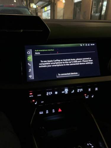

To sum up my problem:
Recieved the ODB app from Steimieyesterday for my audi a3 8y with the ambition to activate Wireless Apple Carplay.
Step:0) Clearad the mmi from my iPhone and removed the car from the WiFi and Bluetooth in my iPhone.
1) Plugged the ODB adapter
2) Popped the hood (not pooped 😉)
3) Ran the sequence for wirless apple carplay
4) Restarted the car
=> No changes in MMI... the smartphone interface asks for usb cable and I cannot find the 5gHz WiFi.
I was able to install the dynamic tail-light, so I know I ran the sequence correctly.
Facts:
Sw: 3272
HW: H8Y0035043
Loacation: Sweden.
Any ideas?

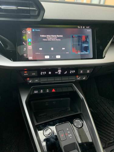

I can now confirm it works. Ran the wrong sequence “unlock third device for MMI”. After running the “apple a3 8y Apple CarPlay wireless and 5gHz wlan activation” WCP works like a charm.
