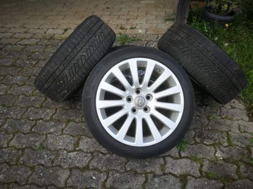

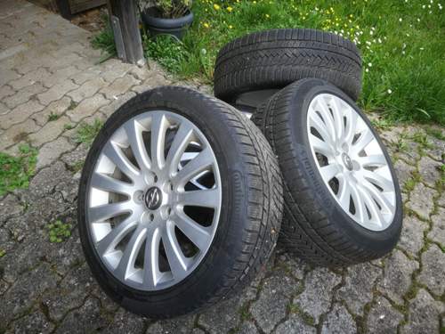

Woher kommst Du denn, habe die 4 Kompletträder zu verkaufen. Die Räder haben Sensor und die Reifen würde ich dann nächstes Jahr ersetzen. Abzuholen im LK Heilbronn Neckar. Gruß

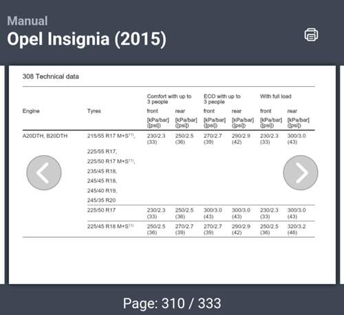

I think standard dimension for summer tires is 225/55R17
For winter 215/55R17 can be used.
Check manual on the end, there is list for every engine.
You dont need to do anything with sensors, just buy tires and replace them. Car will sort it out by itself, if position is changed. Dont need to replace core if valve is not leaking air.

Size with little 11 is winter only tires
I would go with winter 215/55R17
