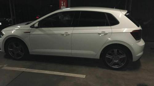

Autec Ionik 7x17
Whatsapp-image-2018-10-11-at-15-02-53
