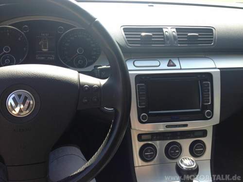

I have this type of MFSW MFSW , with difference that I have white AI.
Which type of MFSW You have?
Thanks,
Marko.
2007 new Buttons were used. Not as the one on the picture.
See in my profile.
The same. My old AI was an white one, too. Part Number 3C0 920 871 T

hmm, what's the difference between Your and butttons on my picture?
am 10. Juni 2013 um 21:04
I see that You haven't got wipper stalk MFD controls, You have only MFSW buttons.
I have both installed and I also tried to disable wipper stalk controls with VCDS, but the problem with non working MENU button remains.
I have seen on some other forum -link that You must retroffit wipper stalk with stalk without MFD controls, to get MFSW working properly.
...So I must find some wipper stalk PINOUT, to try phisicaly cut MFD control wires and see if this is the problem...
