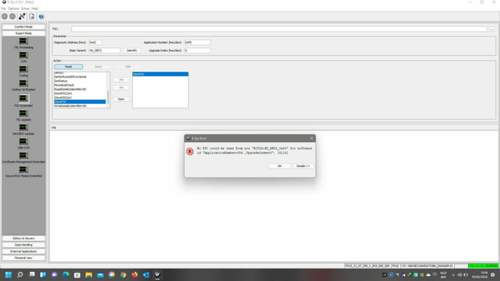

Hello everyone..
I had a retrofit done on my F10 LCI from 2016 from HU_NBT to HU-NBT EVO ID6 ;now i wanted to read out the FSC with Esys but i always get an error. I tried everything but alwas the same error.
Is there someone who can explane why it wont work ? with my original HU-NBT i had no problem reading the FSC with Esys.
@TwointjePan schrieb am 10. Februar 2022 um 14:24:01 Uhr:
Hello everyone..
Picture of the error
