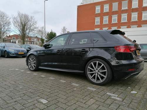

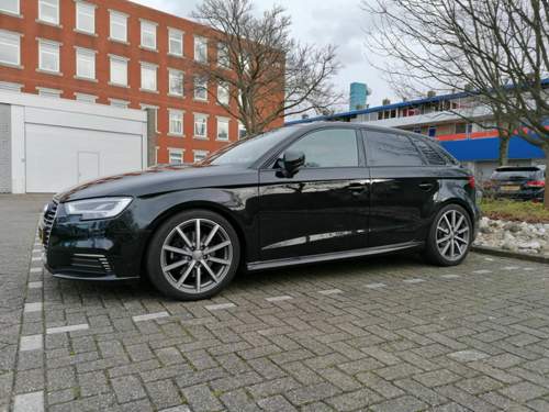

Last week, I (a mechanic) installed a Eibach Pro kit on my Dutch 2017 A3 E-Tron:
- Cornering and sporty driving is sóóóó much more fun. It finally feels like I can 'attack a corner', instead of excessive body lean/roll feelings
- Steering/cornering feels 'about the same' as the 2016 A4 S-line (stock S-Line ride height) I drive at work (which is good/what I wanted to achieve)
-bumps/potholes are bearable but very firm, you can't drive it as fast in urban areas with a lot of bumps as in, for example a 2016 A4 S-line I drive at work... Maybe the stock shocks are to weak? Maybe a combination with Bilstein shocks ore a good coilover kit would have been a better choice?
- Height looks awesome! Just the way I wanted. Maybe even a little lower.... It settled at 64cm on the front and 64.5cm on the back (ground to fender)
So looks are great, but you must keep this in mind while driving, I already scraped something underneath the car and this was only with two persons in the Audi
- If you have a big family/often drive with 3+ persons, this setup is too low and to firm in my opinion (in my case, I drive the car 90% alone, so it is fine for now)
Only 'problem':
After lowering, I can hear a little 'creak', coming from the front.
Hearable when steering while stationary and while driving very slowly, like on parking lots.
It is a constant sound. So not only when reaching full lock.
The sound isn't very hard, but hearable and annoying. Especially because my A3 drives fully electric at those speeds, so normally very quiet.
I asked the mechanic who fitted the Eibach kit and he's telling my he heard this complaint from a lot of A3 8v owners and you can't do anything about it, because often the noise is coming from the struts.
It can also be the control arm rubbers, so he kindly offers me to have a look at them and grease them, to find out if this is the noise/problem.
What are your experiences?
Lowered with Eibach springs

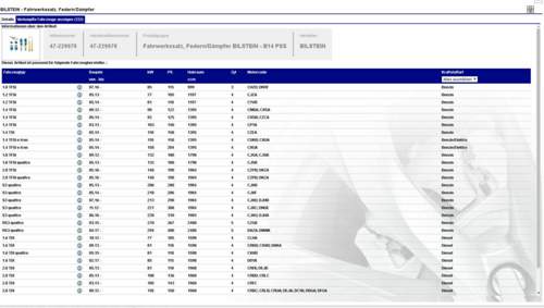

How is it possible that it looks like those coilover kits fit 'all' A3 8v's? See my attached picture...
The E-Tron is heavier than most other A3's, so don't I have to look at the axle loads?
The Eibach Pro kit was also 'specially designed' for the E-Tron...

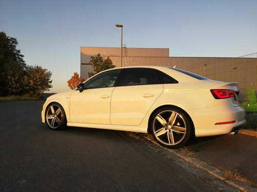

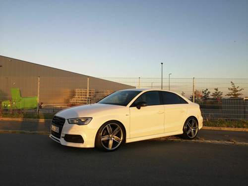

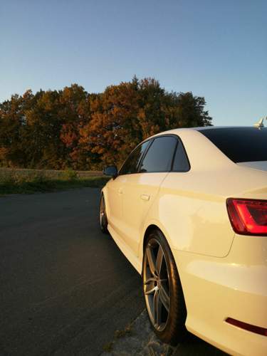

Vorne 15mm Spurverbreiterung je Rad, hinten 20mm Spurverbreiterung je Rad. Tieferlegung mittels H&R-Federn.
Ist echt zu beneiden wie viel platzt in den radkästen der limo ist. Sieht gut aus.
Ja bei der Limo kann man um einiges einfacher und schöner spielen, beim Sportback artet das leider immer gleich aus wenn's ziemlich bündig werden soll..

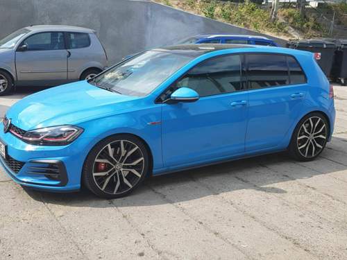

Moinsen!
Habe vor eine neue S3 Limo dem Erdboden etwas näher zu bringen. Hatte bis jetzt mit dem Eibach Pro-Kit sehr gute Erfahrungen im Golf VII GTI, schöne Tiefe (s. Bilder) und angenehme "Härte".
Wenn ich das aber hier so verfolge klappt das beim ner S3 Limo bzw. überhaupt bei ner 8V Limo nicht so ohne weiteres (vorn zu hoch, hinten zu tief).
Daher dachte ich daran, viell. die KW-Gewindefedern (also nur Federn) zu holen. Hat von euch hier damit schon jmd. Erfahrungen gemacht?
... ach so, die Bilder dazu...
