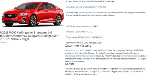

Themenstarteram 24. September 2022 um 18:19
Kennt das schon jemand? In USA hat die NSTHA einen Rückruf bei GM publiziert.
Ein Verlust der Bremskraftunterstützung kann den zum Anhalten des Fahrzeugs erforderlichen Weg verlängern und das Risiko eines Unfalls erhöhen.
Manufacturer Name : General Motors, LLC
Submission Date : JUN 30, 2022 NHTSA
Recall No. : 22V-465 Manufacturer
Recall No. : N222370090
Vehicle : 2018-2020 Buick Regal (Schwestermodell des Insignia)
Zitat:"On April 28, 2022, an issue was submitted to GM’s Speak Up For Safety (SUFS) program based on an Opel investigation of a potential brake-performance issue on the 2019 model year Opel Insignia, a sister vehicle to the Buick Regal. GM opened a formal investigation on May 6, 2022.
GM’s supplier reviewed EBCM software files and determined that a software error in a file supplied by GM could cause the hydraulic-brake boost to fail to respond to a loss of brake-vacuum pressure. Tests conducted on a Buick Regal by GM on June 22 and June 23, 2022, showed that stopping distance following loss of vacuum brake pressure could exceed FMVSS 135 requirements by 1 to 5%. A review of field data identified four field claims received by GM between January 17, 2019 and March 22, 2022 in which the vehicle’s invalid vacuum pressure DTC (diagnostic trouble code) was set and the hydraulic brake boost was disabled. None of these claims involved an allegation that the condition contributed to a crash, and GM is not aware of any crashes or injuries relating to this condition. On June 23, 2022, GM’s Safety Field Action Decision Authority (SFADA) decided to conduct a noncompliance recall."
https://static.nhtsa.gov/odi/rcl/2022/RCAK-22V465-3410.pdf
Übersetzung:
Am 28. April 2022 wurde im Rahmen des GM-Programms "Speak Up For Safety" (SUFS) ein Fall eingereicht, der auf einer Opel Untersuchung eines möglichen Problems mit der Bremsleistung des Opel Insignia des Modelljahrs 2019, einem Schwesterfahrzeug des dem Buick Regal. GM leitete am 6. Mai 2022 eine formelle Untersuchung ein.
Der GM-Zulieferer überprüfte EBCM-Softwaredateien und stellte fest, dass ein Softwarefehler in einer von GM gelieferten Datei dazu führen könnte, dass die hydraulische Bremskraftverstärkung nicht auf einen Verlust des Bremsunterdrucks reagiert. Tests, die von GM am 22. und 23. Juni 2022 an einem Buick Regal durchgeführt wurden, zeigten, dass der Bremsweg nach einem Unterdruckverlust Bremsdruck die Anforderungen der FMVSS 135 um 1 bis 5 % überschreiten kann.
Eine Überprüfung der Felddaten ergab vier Reklamationen, die GM zwischen dem 17. Januar 2019 und dem 22. März 2022 in denen der DTC (Diagnosefehlercode) für ungültigen Unterdruck im Fahrzeug gesetzt und die hydraulische Bremskraftverstärkung Bremskraftverstärkung deaktiviert wurde. In keinem dieser Fälle wurde behauptet, dass der Zustand zu einem Unfall beigetragen hat, und
GM sind keine Unfälle oder Verletzungen im Zusammenhang mit dieser Bedingung bekannt. Am 23. Juni 2022 beschloss die Safety Field Action Authority von GM
Decision Authority (SFADA) von GM beschlossen, einen Rückruf wegen Nichteinhaltung der Vorschriften durchzuführen.

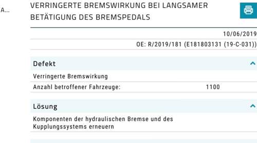

Themenstarteram 6. Oktober 2022 um 18:04
Das ist aber ein anderer Rückruf. Der bei GM beinhaltet ein SW-Update des ABS Steuergeräts.
Omegabesitzer,
Bei meinem System wurde dieser Rückruf am 10/06/2019 schon angekündigt.
Bitte die OE Nummer des Rückruf beachten und das Einstelldatum!
Ich könnte auch noch die VIN mitteilen,
Aber das werde ich mit Gewissheit nicht tun.
Dieser Rückruf wird evtl auch schon Abgearbeitet sein!?
Evtl gibt es ja noch andere darauf gezielte
Rückrufe?
MfG
Screenshot-20221006-200221-firefox
Es können 2 verschiedene Rückrufe sein je nach Fahrzeugmarke .

Rueckruf-insi-b
Mein Insi hat ein Software Update bei diesem (008992) Rückruf bekommen, war beim FOH auch so hinterlegt. mfg.

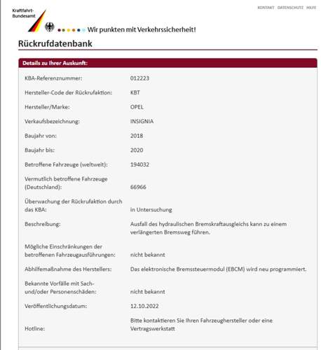

Themenstarteram 14. Oktober 2022 um 21:30
Da ist er nun, der Rückruf.
https://www.kfz-betrieb.vogel.de/.../
Man beachte... „Konstante Qualitätskontrollen haben ergeben ..." Ich werde mal bei Opel anfragen ob ich nun bei denen einen Job habe. Ich bin mir dessen nämlich nicht bewußt.
Themenstarteram 14. Oktober 2022 um 21:37
Auch beim KBA:
Kba-opel-insignia-b-rueckruf
66966 Stück wenn das mal nicht 100% in de. sind. Scheint nicht leicht für Opel zu sein da die richtigen Fahrzeuge rauszufinden.
