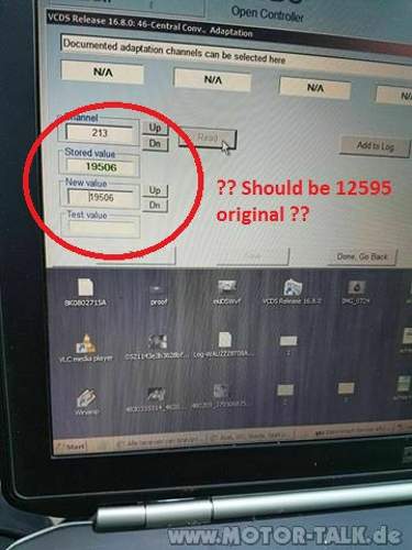

I have a problem with upgrading from Halogen to VFL LED.
All lights function well but when I switch on the rear fog light, only the right fog light switches on and the left reversing light (??). When I switch to reverse both reverse lights come on (so this is good).
I used this coding:
181 64608
189 16380
191 16383
195 5125
196 5157
197 5124
198 5156
203 73
204 105
What did I do wrong?

do you use EU lights or US? When you use the EU you must check the coding again or the cabling ;)
https://www.dropbox.com/.../...en%20Halogen%20-zu-%20VFL%20LED.pdf?...
Using EU lights on RHD vehicle.
The coding in the document is the one I use.
So has to be cables then??
Themenstarteram 24. März 2017 um 15:29
Please check your coding again and check the cabling in my PDF. It may be true that the RHD use other cabling or coding but I think it is the same...
All is according your coding and cabling. I am really puzzled :S
Themenstarteram 25. März 2017 um 0:05
Can you upload a video of this behaviour?
I need the original values of channels 181 to 213 of an original 2010 sportback with PFL LED. Can somebody help me?
see thread and search
Scotty, I also need the channels that you are NOT supposed to change while coding rear lights. Something has gone wrong while coding (VCDS crashed). When I tried to recode them there were completely wrong values in the "current value" box. These were not the values that are in the "old wert" table. I think it must have changed all channels in wrong values. I recoded the channels that you are SUPPOSED to code to the FL values. But lights not functioning ok.
Problem is that the blinkers are burning continously together with the rear light.
When blinking the right (or left) blinker goes brighter/less brighter usw usw...
See video...
Also the old value of 213 was 19506 (and this should be 12595?), I changed it to 17458.
17467662-1233746290074015-1860818705-n
try this eu version without sidemarker
