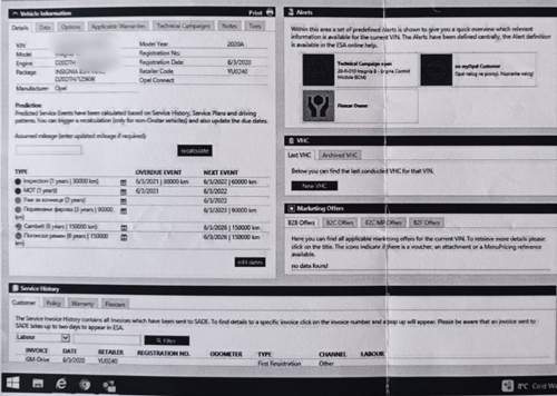

But next service is shorten for that period(or km).
Service...14month....service....10month....service-OK
Service...14month....service....12month....service-NOT OK
Same for km.
Had service 15.3.2023, sheduled for 14.3.2024, I canceled it, then service canceled me for 20.3(no guy for multimedia firmware update, vacation), done service yesterday 25.3....all good
What is funny, parts they change during regular service is like lottery...they ask if I wont fuel filter change. I sad it was changed 2 service before( maybe 20.000km, past service only oil and oil filter+rear brake pads with my confirmation)...ok, we wont change it?!?
Air filter is replaced on all services except one before(2023)??? Cabin also on all services and its pretty pricey
Manual said nothing about periods for filter replacement
Does someone have info on how many km/years fuel, air,
cabin filters are changed? D20DTH
I can share Opel info on
brake fluid-2 years
Cambalt 6 years/150.000km
PK drive belt 6 years/150.000km
Oil 5L........... 38.3eur dexos2 5W-30, opel or Total
Oil filter.........31e
Cabin filter...41.75?!? Carbon model
Air filter....... 27.85e
Work, 1h......43.5e
