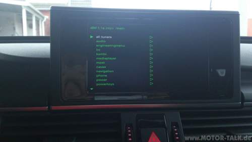

Was ich leider bis jetzt nicht gefunden habe, ist eine Aufstellung über die einzelnen Funktionen / Befehle im Hidden Menü....
Gibt es da eine Liste, oder sollen wir hier mal alle bekannten Optionen sammeln, da sie ja nicht wirklich selbsterklärend sind.

I have successfully enabled hidden menu, but i don´t have CAR option in green menu. Please help!
Dsc-0639
i think in the "low" unit is no "car"

You mean that it´s not possible with MMI®-radio plus?
@Sanel
what would you like to do in the hidden menü?
not all works in the small mmi like in the mmi touch.(3g+)

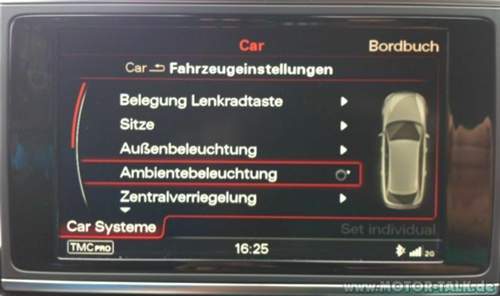

i want to enable interior light menu on MMI. can i do that with vcds only?

I also tried to enable this, but I was not able to find any information, how to enable this. There is also no option in the Hidden menu.  One additional reason for me to retrofit the 3GP
You have to enable the lights via VCDS. If you only enable the menu, the lights are not working.
To enable the ambient lightning themselve (in the Bordnetzsteuergerät) is no problem, but to get it in the MMI low (RMC) configurable - I found no way to do this.
it makes no sense for me. exterior light is already enabled on mmi low, but interior not. we just have to try harder ;).
