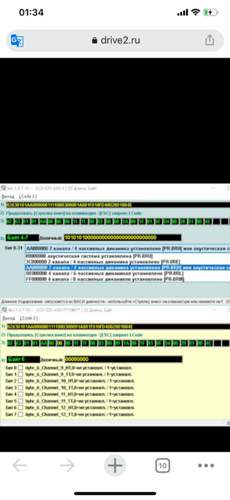

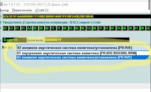

I have some questions about speakers and amplifiers (RP-9VI). I saw it (9VE). I replaced the Phaeton 12 speaker and amplifier. 3D0 035 466D-Option 9VI ("Dynaudio")-May 5, 2012. My car is Volkswagen CC, host model: 5C0035680G. I cannot see the "Edit (9VI)" option
Ask for help
