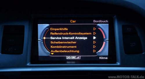

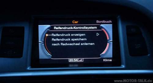

I wait someone who can give the ABS unit code to finish TPMS mod
do you if it s possible to show the outside temp in the bottom of the MMI screen?
and if it s possible to retract the outside mirror when you close the car like Q5 ?

http://audienthusiasts.com/VagComABS.htmlZitat:
...on my car it works pretty good
I wait someone who can give the ABS unit code to finish TPMS mod...on my car it works pretty good
This code doesn't work on an A6
What is the reason for?
regards DVE
