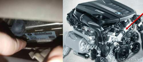

Where do I exactly find this number/ AGR cooler? Is it easy to see or do I need to disassemble something before? Thanks!
...siehe Bild
AGR-Kühler-Sticker

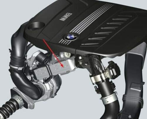

@Gorerix schrieb am 22. Januar 2019 um 17:47:42 Uhr:
@fraatti schrieb am 22. Januar 2019 um 17:27:54 Uhr:
I heard today that they won't change the intake anymore. It seems that the campaign is living all the time. They will just check what is the index number of the egr-cooler. If it is below 08 then they will use endoscope for checking is the any signs of coolant leaks.
Index number is the two last digits. This is egr-cooler from N57 535d and the index number is valid for this part number 78230210.
Just pull engine cover up and move sound/heatinsulation littlebit off from the front of engine. The label is at front side of of the cooler.
Coolerlocation
