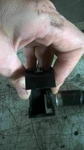

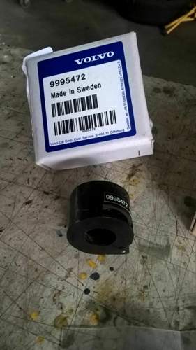

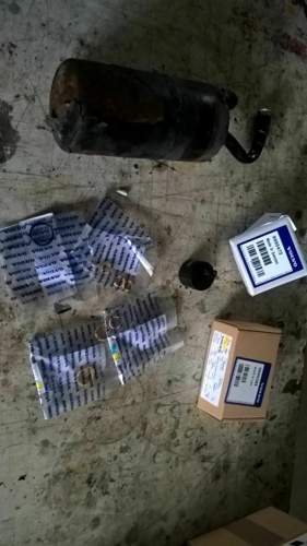

Markus
Wp-20160630-19-56-33-pro
Wp-20160630-19-56-47-pro
Wp-20160630-19-57-12-pro
