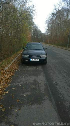

Wp-20151114-10-40-37-pro
Wp-20151114-11-01-36-pro
Wp-20151114-11-01-43-pro
