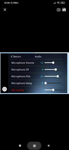

Hat sonst noch jemand Probleme mit dem Echo beim Telefonieren?

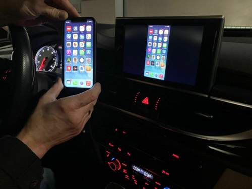

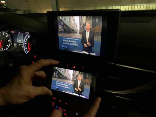

@RainerHarke
Die Ansicht auf den zwei Fotos ist aber Airplay. Oder ?
Die Bedienung läuft dabei ja über das "Handy".
@4f4f4f
Irgendwo unter Setup kannst Du da glaub was anpassen.
Korrekt.
Mein Ziel ist dennoch voll erreicht.
Tagesschau und Tagesschau in 100 Sekunden und YouTube.
Das gab es als ansatz für die Echo Minderung.
There are four options for microphone sound quality:
'Microphone Volume' Used for microphone volume amplification;
'Microphone OP Gain' Used to rough adjustment for adjusting analog
amplification;
'Microphone OP Gain' Used to fine adjustment for adjusting analog amplification;
'Microphone AEC Delay' Used to adjust echo cancellation delay parameters;
'Microphone AEC Quality' Used to adjust the quality level of echo cancellation.
Step1: Set as the following picture shows
Step2: First you need to call someone, then adjust the volume according to the volume you hear. If the sound you hear is too low, you need to increase
'Microphone OP'. If the sound is too loud or noisy, you can decrease 'Microphone PGA'.
Step3: Adjust the Microphone Delay value until there is no or minimal echo.
When the echo is small, you can increase 'Microphone volume' a little
If the echo is still loud, decrease the 'PGA' first, and then continue to adjust the 'Delay' value.
After the three steps, if the sound is too low, you can increase 'Microphone
volume'
Note: If the sound is distorted, please adjust 'Microphone OP'
